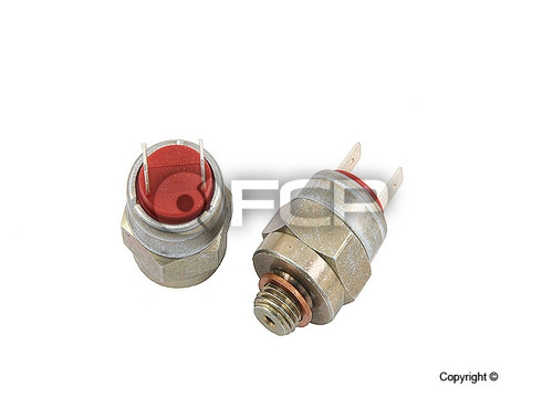

Fluid Pressure
Brake pressure sensors will be used to capture inline brake fluid pressure. Combining this input with brake pedal travel can provide a way to show brake fade in real time.
Quattro Brake Fluid pressure sensorFile:Http://s3.amazonaws.com/fcp-product-photography-us/public/assets/products/77553/product/open-uri20120713-31620-geo69a.?1342170655 http://s3.amazonaws.com/fcp-product-photography-us/public/assets/products/77553/product/open-uri20120713-31620-geo69a.?1342170655 $31.55
