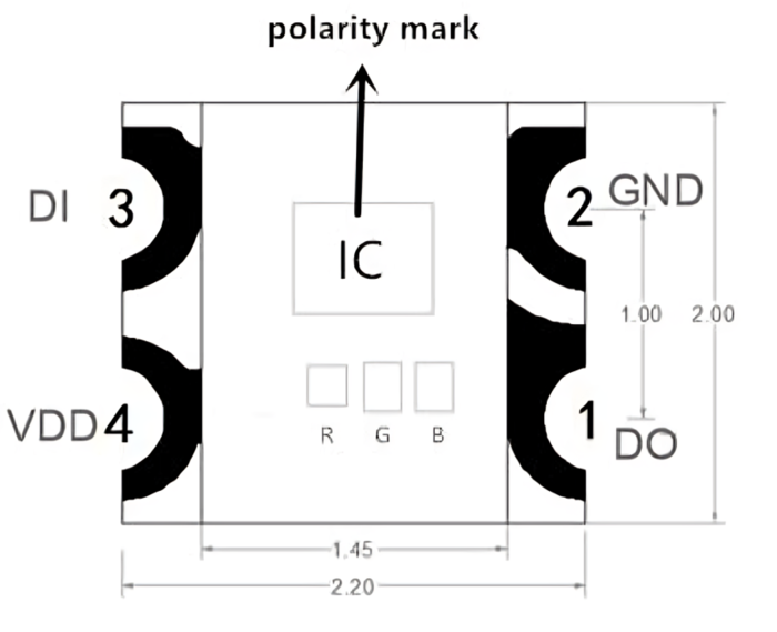

The hardware of the WS2812 LED module is as follows:
WS2812 RGB LED Pin Description
Pin Description of the WS2812B LED with 2020 package is as follows:
| Symbol | Description |
| DO | Data Output (DOUT): Outputs the control data signal to the next device in the chain. Used for cascading multiple modules or LEDs to create a series connection. Connect to the DI of the next module in a daisy-chain setup. |
| GND | Ground: Connect to the ground (0V) of the power supply. Ensures stable operation by providing a common reference point for the circuit. |
| DIN | Data Input (DIN): Receives the control data signal from the microcontroller or the previous device in the chain. Used for controlling the LED or module by sending data signals through this input pin. |
| VDD | Power Supply: Connect to a 5V DC power source to power the module. Ensure a stable and sufficient power source to support the device’s operation. |
