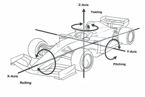

Systems with an on-board IMU should be mounted in the default orientation, typically with the device connectors oriented towards the front of the vehicle.
  • Note Check the model's documentation for the specific mounting guide.
Mounting in an alternate orientation
The system can be mounted in an alternate orientation, ideally in square 90 degree increments. For example:
  • Inverted mounting
  • Flat / upright, but rotated 90 degrees
  • On-edge, but aligned with the front-rear axis of the vehicle
Re-orientation requires re-mapping of the accelerometer channels, using the RaceCapture app
Re-orientation procedure
Preparation
Prior remapping, creata a temporary racecapture dashboard with the 6 channels (AccelX, AccelY, AccelZ, Yaw, Pitch, Roll)
Detach the system from the vehicle, and visually note the behavior of each channel by moving the system about in free air. See the diagram for reference:
Remapping channels
Now, hold the device in free air at the new orientation, and then swap / invert IMU channels using the RaceCapture app to attain the behavior seen with the default orientation and default channel mapping settings.
Zero Calibration
After orientation is updated (as needed) and the system is mounted to the vehicle, ensure the vehicle is on a level surface. Then, perform a final zero calibration by pressing the Calibrate button in the RaceCapture app. This will zero out all 6 axis. At this point you can perform a final write / save of your configuration

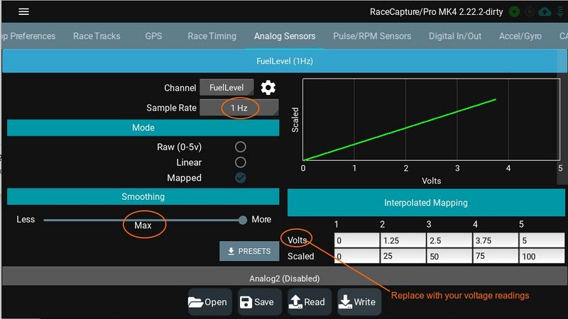

Fuel Level Sensors
Fuel Level Sensors are usually variable resistance based sensors, and provide a variable resistance based on the level of the float.
Calibration
With the fuel at different levels, measure and note the voltage present at the RaceCapture analog input for different fuel levels:
  • Empty (0%)
  • 1/4 (25%)
  • 1/2 (50%)
  • 3/4 (75%)
  • Full (100%)
Set up the Analog Channel
  1. Choose an available analog input for your Fuel Level channel, then select the basic fuel level preset by selecting Fuel Level in the dropdown list. (This pre-sets the units (%), logging precision and min / max values. You can edit this by pressing the gear button next to the channel name
  2. Set the sample rate to 1Hz.
  3. Set the mode to Mapped. This will let you create a curved mapping for the sensor voltage.
  4. Set the smoothing to Maximum - this will help account for variances due to fuel slosh.
  5. Enter the mapped values noted in the calibration process into the Analog Channel mapping editor under RaceCapture setup. This will provide the calibration curve for your fuel tank.
  6. Write these settings back to RaceCapture and observe your fuel level readings in units of percentage.
Example BMW E36 fuel level mapping
Example BMW E36 Fuel curve mapping (your sender's calibration will be different)
