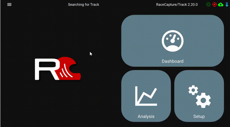

  • Launch the RaceCapture app to begin configuration. The app will automatically start the First-Time Setup Wizard to guide you through the initial setup process.

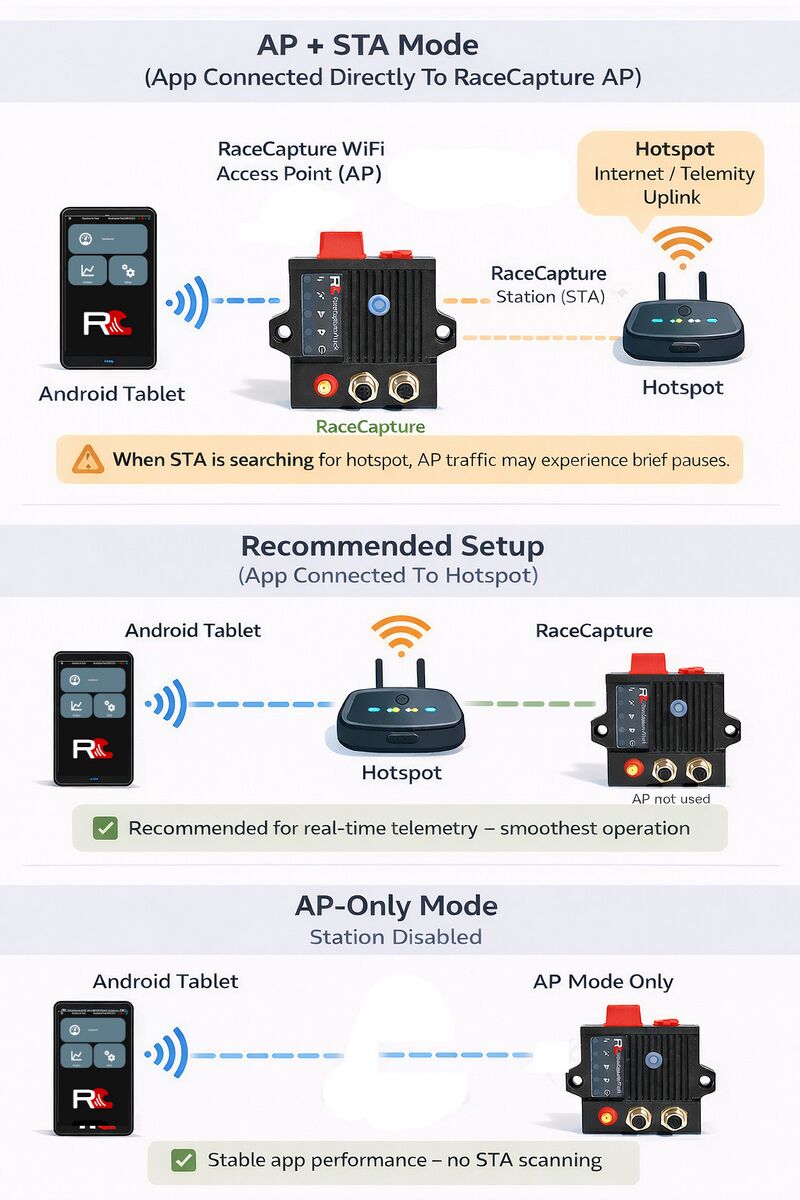

Wi-Fi Operating Modes
RaceCapture/Track MK4 support multiple Wi-Fi operating modes to accommodate different configuration, connectivity, and telemetry use cases. Firmware version 2.23.3 introduces significant improvements to Wi-Fi reliability and connection behavior across all supported modes.
Access Point (AP) Mode
In Access Point (AP) mode, the device creates its own Wi-Fi network. The RaceCapture app connects directly to the device’s access point.
  • Simple, direct connection between the app and the device
  • Does not require an external hotspot or router
  • Provides stable app connectivity
  • Internet access is not available unless bridged through another device
This mode is useful when operating without external network infrastructure or when a direct connection is preferred.
AP + STA Mode (Access Point + Station)
In AP + STA mode, the device operates simultaneously as:
  • A Wi-Fi access point for the RaceCapture app
  • A Wi-Fi station (STA) connected to an external hotspot for internet access or telemetry uplink.
When operating in this mode:
  • If the station is connected to a hotspot, telemetry and internet services can be routed through the hotspot.
  • If the station is actively searching for a hotspot, brief pauses in access point traffic may occur while Wi-Fi scanning is in progress.
Note: During hotspot scanning, short interruptions in app communication are expected behavior.
Recommended Setup (App Connected to Hotspot)
For the smoothest real-time telemetry performance, the recommended configuration is:
  • The RaceCapture app connects to the same hotspot as the device
  • The device operates primarily as a Wi-Fi station
  • The internal access point is not used for app communication
This configuration minimizes Wi-Fi scanning activity and provides the most stable telemetry operation, especially in dynamic or congested wireless environments.

  1. In the RaceCapture app, navigate to Setup
  2. Select TPMS
  3. Select Register Sensor.
  4. When the sensor is detected, add it to the sensor list.
  5. Assign the sensor to the appropriate wheel position.

  • Open the app and navigate to Setup > Driver ID.
  • Enable both Driver ID and Heart Rate options, then click Register Device.
  • Register each Bluetooth device one at a time.
Important: Only power on one device during each registration to avoid incorrect pairing.
  • After all devices are registered, press the Write button to save the configuration.

  • The connection method can be changed within the RaceCapture app:
  • Open the RaceCapture app.
  • Navigate to Setup → App Preferences.
  • Select the desired connection type (Bluetooth or Wi-Fi).
  • Return to the main screen and reconnect using the selected method.
