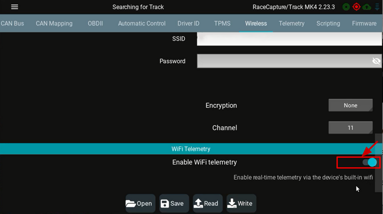

* Select the Wireless tab. | |||
* Configure the following settings: | ** Configure the following settings: | ||
** Enable WiFi Support | *** Enable WiFi Support | ||
** Enable Client Mode | *** Enable Client Mode | ||
** Enter the SSID and password for your hotspot or WiFi network | *** Enter the SSID and password for your hotspot or WiFi network | ||
'''Note:''' The hotspot must support 2.4 GHz WiFi. Many hotspots default to 5 GHz, which is not supported. If necessary, configure your hotspot to allow 2.4 GHz operation. | '''Note:''' The hotspot must support 2.4 GHz WiFi. Many hotspots default to 5 GHz, which is not supported. If necessary, configure your hotspot to allow 2.4 GHz operation. | ||
For testing purposes, you may use your phone’s hotspot to confirm the connection is working correctly. | For testing purposes, you may use your phone’s hotspot to confirm the connection is working correctly. | ||
* Enable WiFi Telemetry at the bottom of the Wireless settings. | |||
[[File:Enable wifi telemetry option.png|750px]] | |||

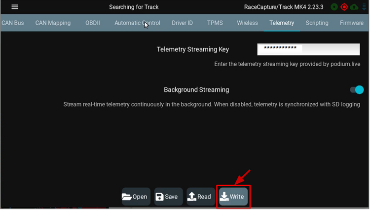

=== Step 2 : Configure the Telemetry Streaming Key === | |||
[[File:Telemetry streaming key updated.gif|750px]] | |||
To stream telemetry to Podium, you must enter a Telemetry Streaming Key. | |||
* Open the Podium website. | |||
* Navigate to Settings → Devices. | |||
* Select your device from the list. | |||
* Copy the Streaming Key shown for the device. | |||
Return to the RaceCapture app: | |||
* Navigate to the Telemetry tab. | |||
* Paste the Streaming Key into the Telemetry Streaming Key field. | |||

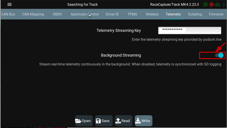

=== Step 3 : Configure Streaming Behavior === | |||
[[File:Background streaming key.png|750px]] | |||
For testing or continuous streaming '''Enable Background Streaming'''. | |||
This causes the device to begin telemetry streaming immediately after power-up. If Background Streaming is disabled, telemetry streaming will begin only when the system starts logging based on its configured trigger (typically vehicle speed, but other channels such as RPM may be used). This helps prevent unnecessary telemetry transmission when the vehicle is powered but not actively driving. | |||
=== Step 4: Apply Configuration and Reboot=== | |||
Click Write to save the configuration to the device. | |||
[[File:Configuration (write).png|750px]] | |||

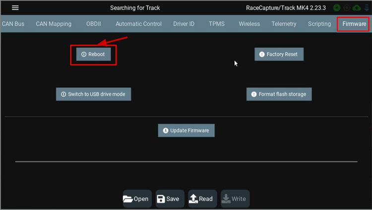

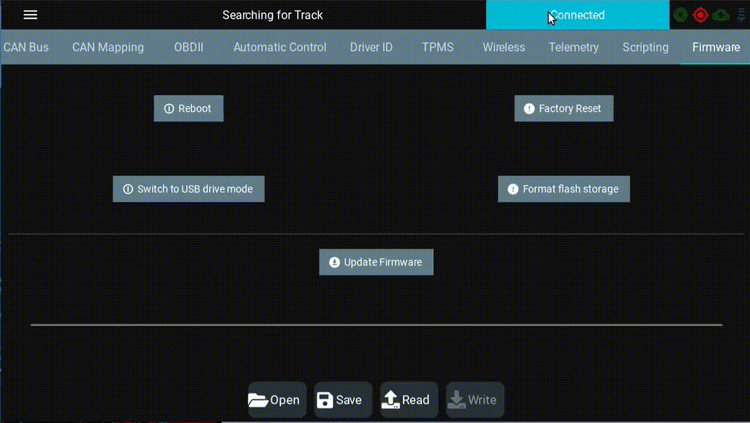

Reboot the device by either: | |||
* Power cycling the unit, or | |||
[[File:Rebot.png|750px]] | |||
* Navigating to Setup > Firmware > Reboot. | |||

Step 1 : Configure WiFi Connectivity
- Open the RaceCapture app and connect to your device.
- Navigate to Setup from the main screen.
- Click Read to load the current configuration.
- Select the Wireless tab.
- Configure the following settings:
- Enable WiFi Support
- Enable Client Mode
- Enter the SSID and password for your hotspot or WiFi network
Note: The hotspot must support 2.4 GHz WiFi. Many hotspots default to 5 GHz, which is not supported. If necessary, configure your hotspot to allow 2.4 GHz operation. For testing purposes, you may use your phone’s hotspot to confirm the connection is working correctly.
- Enable WiFi Telemetry at the bottom of the Wireless settings.
- Open the Podium website.
- Navigate to Settings → Devices.
- Select your device from the list.
- Copy the Streaming Key shown for the device.
- Navigate to the Telemetry tab.
- Paste the Streaming Key into the Telemetry Streaming Key field.
For testing or continuous streaming Enable Background Streaming. This causes the device to begin telemetry streaming immediately after power-up. If Background Streaming is disabled, telemetry streaming will begin only when the system starts logging based on its configured trigger (typically vehicle speed, but other channels such as RPM may be used). This helps prevent unnecessary telemetry transmission when the vehicle is powered but not actively driving.
- Power cycling the unit, or
- Navigating to Setup > Firmware > Reboot.

To enable USB drive mode:
- Ensure the system is connected to your desktop or mobile device via USB cable.
- Navigate to Setup > Firmware.
- Press the Switch to USB Drive Mode button to access stored log files directly.
Important Caveats:
- App connectivity will be temporarily disrupted if using a USB connection (Windows, macOS, Linux).
- The system must not be actively logging or broadcasting telemetry when switching to USB drive mode.
To exit USB drive mode and resume normal operation:
- Fully power cycle the system by disconnecting both USB and 12V power.
Formatting Flash Memory:
- Connect the system to your desktop or mobile device.
- Press the Format Flash Storage button.

- Download the latest RaceCapture firmware from Firmware
- Unzip the archive to a location on your computer
- Connect RaceCaptureTrack MK4 via USB (Windows or OSX only)
- In the RaceCapture app, navigate to Setup and press the Firmware menu option.
- Press the Update Firmware button
- Navigate to the RaceCaptureTrack MK4 firmware you unzipped. The file will end with the extension '.ihex'. Example: PodiumConnect_2.15.2.ihex
- Press Open
The firmware update process will begin, and will complete when the gauge is 100% After re-connecting, the firmware version should be updated in the connection message at the upper right-hand corner.
