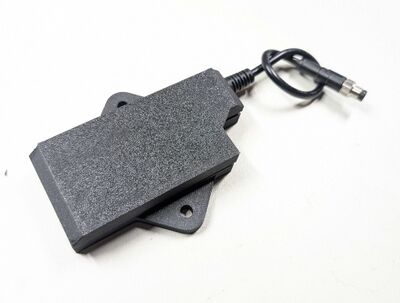

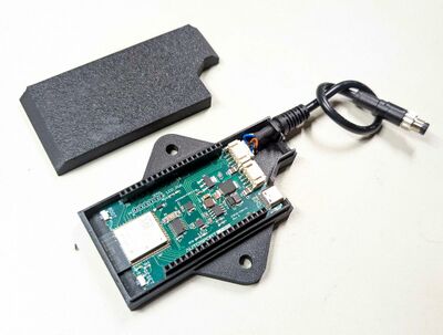

=3D printed enclosure= | |||
You can 3D print your own enclosure - files [https://github.com/autosportlabs/ESP32-CAN-X2/tree/main/enclosures available on Github]: | |||
[[file:esp32-can-x2-pigtail-3d-printed-enclosure-cover-off.jpg|400px]] | |||
[[file:esp32-can-x2-pigtail-3d-printed-enclosure-cover-on.jpg|400px]] | |||
