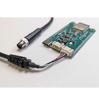

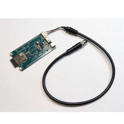

Pigtail for Plug and Play Harness
A pigtail is available for connector X1 and X2 that can integrate with the Autosport Labs plug and play harness system. This pigtail can provide power + CAN data to the board.
