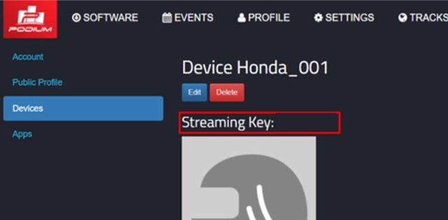

Create Your Podium Account
Create Device and Streaming Key
  • Create an account on Podium
  • Setup the Device Name
  • Make a note of the Streaming ID provided, so you can enter it into the wizard later.

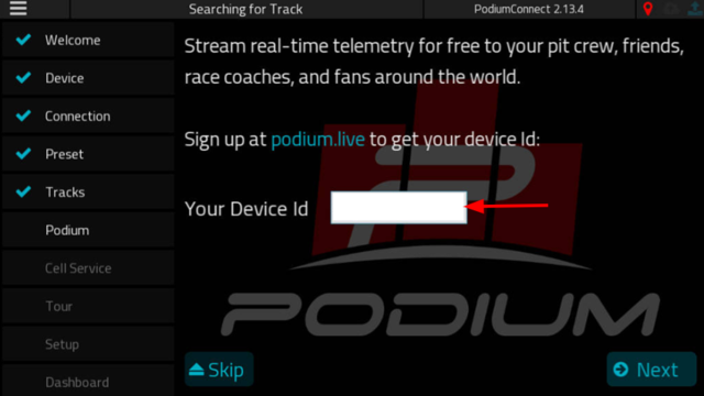

Configure Telemetry Streaming Key
  • Enter your unique Streaming Key in the Device ID section to enable live telemetry on Podium.

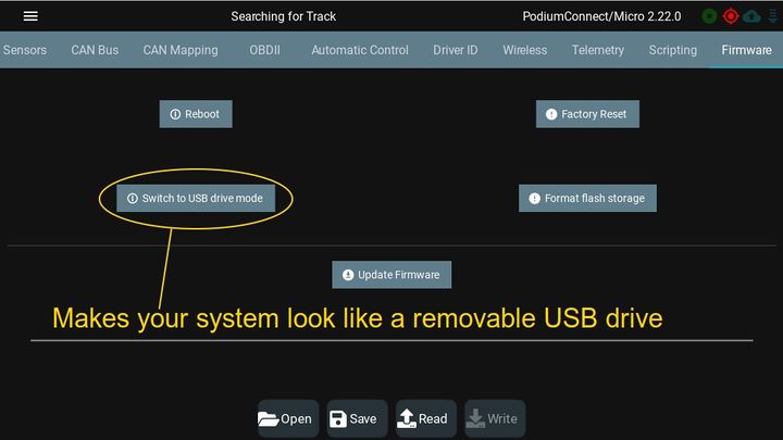

Accessing Flash Memory for Log File Transfer
PodiumConnect/Micro logs data locally in addition to live telemetry streaming. These logs can be accessed by mounting the system as a USB flash drive.
To enable USB drive mode:
  • Ensure the system is connected to your desktop or mobile device via USB cable.
  • Navigate to Setup > Firmware.
  • Press the Switch to USB Drive Mode button to access stored log files directly.
Important Caveats:
  • App connectivity will be temporarily disrupted if using a USB connection (Windows, macOS, Linux).
  • The system must not be actively logging or broadcasting telemetry when switching to USB drive mode.
To exit USB drive mode and resume normal operation:
  • Fully power cycle the system by disconnecting both USB and 12V power.

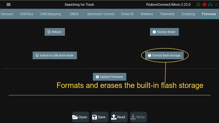

Formatting Flash Memory:
  • Connect the system to your desktop or mobile device.
  • Press the Format Flash Storage button.
Note: This process only deletes log files and cache data; it does not affect system configuration or firmware.
  • Create an account on Podium.
  • Open the Settings section and Add the name for your device.
  • Once your device is created, a Streaming ID will be generated. Make a note of this ID, so you can enter it into the RaceCapture wizard later.

  • Once installed, Connect your Podium Connect Micro to your computer with the USB cable,
  • Start the RaceCapture app.
  • The RaceCapture app will launch the first time setup wizard.
Android/iOS
  • Get the latest version of the RaceCapture app from the following.
  • Power up Podium Connect Micro with 12v or via USB power (computer or USB power source)
  • Go to your device's WiFi settings, and connect to the Podium Connect Micro WiFi access point.
  • Note that the WiFi Access Point is open, with no password - you can set a password and encryption later under Setup.

Below are the steps for updating your firmware.
Backing Up Configurations
Updating firmware can cause your Podium Connect Micro system to be restored to factory settings. Before updating firmware, save your settings to a file. Steps:
  • Connect to Podium Connect Micro using the RaceCapture app - using USB, or WiFi.
  • Navigate to Setup and press the Read button to read the current settings from Podium Connect Micro.
  • Press Save to save your settings to a file. These will be later restored after firmware is updated.
Updating Firmware
  • Download the latest Podium Connect Micro firmware from http://podium.live/software
  • Unzip the archive to a location on your computer
  • Connect Podium Connect Micro via USB (Windows or OSX only)
  • In the RaceCapture app, navigate to Setup and press the Firmware menu option.
  • Press the Update Firmware button
  • Navigate to the Podium Connect Micro firmware you unzipped. The file will end with the extension '.ihex'. Example: PodiumConnect_2.15.2.ihex
  • Press Open
The firmware update process will begin, and will complete when the gauge is 100% After re-connecting, the firmware version should be updated in the connection message at the upper right-hand corner.

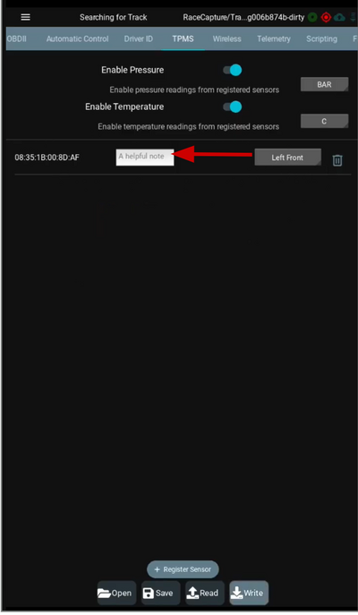

Registering TPMS Sensors
  1. In the RaceCapture app, navigate to Setup
  2. Select TPMS
  3. Select Register Sensor.
  4. When the sensor is detected, add it to the sensor list.
  5. Assign the sensor to the appropriate wheel position.
Each sensor is identified by a unique sensor ID and signal strength indicator.
Sensor Identification Notes
Each TPMS sensor supports an optional short text note that can be used to identify a specific wheel or tire set (for example, wheel type or tire model).
